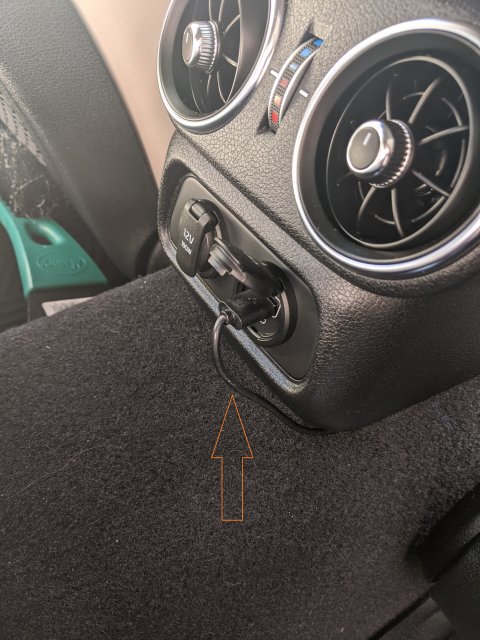

My dash cam came with an 11 foot power (USB) cable. This is the third car I've had it in. The ONLY two places the cable shows can be seen in these two photos. The rear seat USB is only active when the ignition is ON. I really did not want to hardwire it to the car because I change cars pretty often. Take just a few minutes to remove and/or install the cable. Perhaps once a year will somebody ride in the rear seat-- so as far as I am concerned the cable is hidden.
